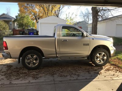

Here's mine set @ 2.8 without any rear spacer.... thinking I'm gonna do a 3/4" rear spacer this spring, maybe.... can't decide???

Mines at 2.8 on front, nothing on rear and its perfect.
