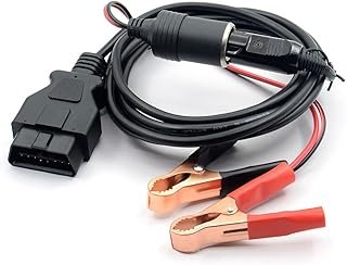

I have always used a "memory saver" when I change out batteries. Maybe it is just a peace of mind thing, or just a little "OCD", but it works for me. Just a simple inexpensive one that plugs into the OBD II port. Something like this I use with a Jump Pack. Some say say it is not necessary, but I still do it anyway.

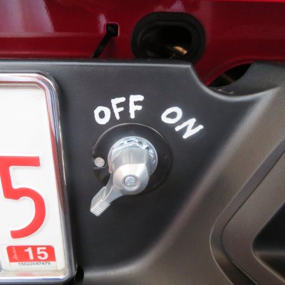

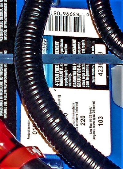

Wildone, will the stock alternator fully charge the H8 battery? Thanks
With no issues. My truck had no issues charging this monster Group 31 AGM, it also sat a good 15+ feet from the stock location,and ran through 2 master disconnect switches.1 switch on the battery box itself and 1 switch in the back bumper to be NHRA legal.
Part NumberNAU31PLAGM
Industry Group Size #31DT
Battery TypeAGM (Absorbed Glass Mat)
Battery UseDeep Cycling, Starting
Battery Voltage (Nominal)12
Cold Cranking Amps (CCA)1150 A
Cranking Amps (CA)1370 A
Reserve Capacity (RC)220 min
Maximum Length (in)12.89 in
Maximum Width (in)6.76 in
