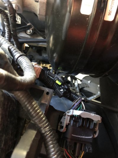

The GPS in my 2016 RAM took a dump. Used the GPS 4 days ago and everything was normal. Tried it yesterday and it still thinks I am 35 miles from home, where I turned the GPS off 4 days ago. There are no bars showing on the GPS signal strength. What does a soft reset of the Uconnect 8.4 system reset? I know the latest software is 18.45.01 and I have 18.11.07. I’m reluctant to update the firmware as everything else on the Uconnect is working. I'd hate to try and update the firmware and end up bricking the system and then nothing would work. Before I pay a dealer $1.5k to $2K to replace the system I’ll buy the largest Garmin GPS and just sit it on the dash. At least with the Garmin I’ll get a free lifetime of map updates. Seems like RAM could have installed a more reliable system.
At least doesn’t show you in 2200 miles away. Ended up taking it to the dealer because it was ghost touching as well. They tried the update and it bricked my radio and the Uconnect and dash lights would never turn off so I finally found the fuse while I wait for the new system to come in. I won’t have ac/fans or screen for now
