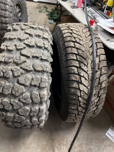

I run studded Hakkapelliitas! By far, the best icy road snow tire ever! BUT, if you plan on wheeling deep snow off road, not so great!
I rand D rated Duratracs on my Tacoma, year round! I wish they wore as well on the full size! Great all around tire!
5FB12ED2-9864-4585-8B9C-F89FB12F6948.jpeg97BB27B1-D396-4588-A280-098C1A7104A8.jpeg8F81345E-CD10-4300-888C-F126E087D255.jpeg
I think when my Hakkas wear out, I’ll go to studded E rated Duratracs!?!?
