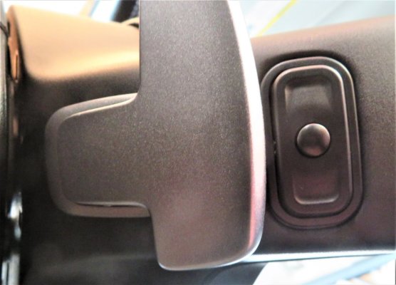

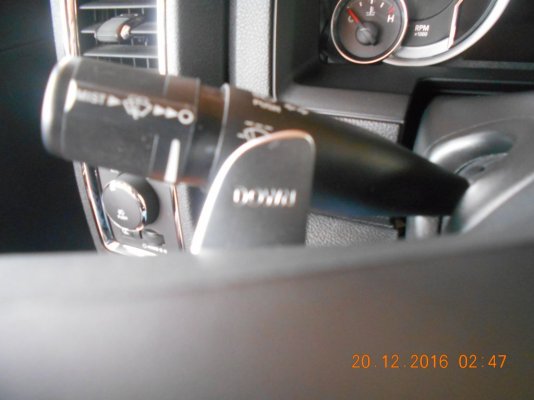

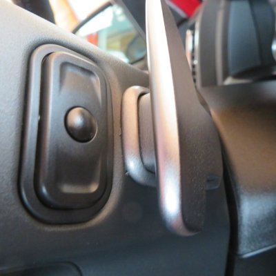

It also kills mds mode,but i'm not a huge fan of defeating the mds system with a stock cam.
One of the best mods i did,was have my buddy install his paddle shifter kit in my truck about a dozen years ago.
I actually prefer the trucks paddles over the tiptronic paddles in the cars,i used the trucks paddles all the time,and very seldom ever used them in the wifes Challengers or our 300.
That is one of the mods I want to try on my truck. Seems like a better solution than the buttons. Might pick up a used steering wheel to try it on.
Out of curiosity what are those paddle shifters from that you installed on your truck?
Also, is there a thread about the installation?
They're Mercedes AMG paddles. No thread on the install. My buddy did 3 of them back in early 2015,but @Brandon-w figured out how he did them several years later and was building a kit to install them,so check and see if he still has enough parts on hand to build you a kit.
