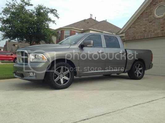

I just installed a new set of 20x9 +18mm offset wheels on my crew cab 4wd with 305/50/20 tires, and I don't have any rub at all. I am also running the Ground Force 2/3 drop.
