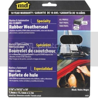

Chances are you won't have a problem with the third brake light, but it seems to happen a little more than usual.
You could be proactive and seal it, it is simple to do. Two screws hold it in and a connector for the light. Just clean the old gasket and install a new one. I did this to mine way beck in 2010 and never had a problem and never worry about it.
I bought this in one of the big box stores years ago, I am sure you would be able to find it or something very similar.
I wouldn't recommend RTV sealant for the simple fact that if you have to replace the bulb it would be a pain to remove the light assembly later for a bulb replacement.

I just did this fix this weekend. 25 minutes tops. When I took off the brake light I was surprised to see some closed cell foam for the gasket not cardboard. I pulled off the foam... it was deteriorated, but not bad... actually had to cut it off with razor knife and scraped the residue with the blade. I fit the new foam onto the lens and reinstalled.
I went to Lowe's to get my gasket material... they do not carry the MD brand but found Weather King, same stuff in white only. I bought the white. White foam completely invisible when installed.
Foam cost like $5, time was about 25 minutes. If it leaks now it is my fault.
