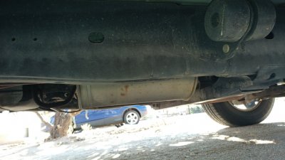

My 06 they're between the cats and muffler. They can be anywhere in the system, I've just seen them between the cats and muffler mostly. Just for reference, my whisper quiet stock system that I plan on upgrading to a Flowmaster American Thunder 17423 or 817423 as soon as I have the funds. :)
View attachment 136396 View attachment 136397 View attachment 136398
The 06's are strange.. I only have 1 resonator and it was after the muffler. Some 06 owners say they have one before the muffler and others don't. Maybe just the Hemi gets 2 resonators??

I've been talking with some of my truck buddies at work and I definitely have a unique setup. None of them have ever seen or heard of 3 cans in the system (we're calling them that because they look like coffee cans). What we're thinking is that my system is resonator, muffler, muffler since that last can looks like a Super 44 with no Flowmaster stamping and it looks newer than the rest of the system. We have no earthly idea why this was done other than possibly ignorance by a previous owner. All the pictures/drawings I have found on AllData and the FSM show one large muffler for the 5.7L Hemi and nothing else. :wtf2:
