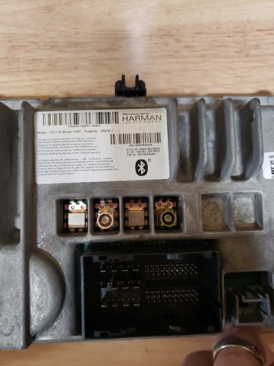

Hey guys, i have a question. My wife just bought me the 8.4 upgrade for my 2014 1500 from Infotainment.com. it came in last night, and while unpacking it i noticed the radio had no purple connector for the 911 bypass that was included in the bundle. It only has the white and yellowish conectors on the back. She ordered the RA3 without Nav. Why would they send the 911 bypass if the radio doesnt have the port for it? Thanks!

I think that is a Canadian radio. If it works in your truck, that is one less thing to worry about.

It is definitely a Canadian radio. The VP3 CA stands for Canada. The U.S. version is the VP3 NA which stands for North America.
