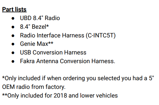

I didn't see that included in the infotainment kit so if you already have an 8.4 it doesn't sound like it's necessary.

I did some research on that part number (C-INTC5T) and it’s the same harness kit that they used for the 2019-2021 Ram Heavy Duty Uconnect 5 upgrades, which tells me that it will most likely be plug and play.
