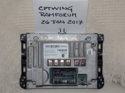

Unfortunately I had to cancel this sale and refund 12Ram. The reason I cancelled the sale was the radio would not boot in my truck which is a 2014, it may be ok but I could not in good conscience sell this radio to anyone. There have been know issues with putting 2016 radios in prior year trucks so the radio maybe and likely is fine. I am going to investigate with Navrepair.com to see if they can shed any light on this. As part of the return I also covered all paypal fees.

Great seller really wished it would of worked out but definitely a stand up guy! Awesome communication!
