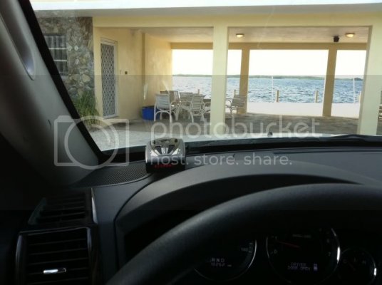

This how I always run mine. Run the wire down the dash and into the fuse box. Very easy. I even got a complement from a cop on how it blends into the dash and he couldn't see it. Lol. Also note I bent the brackets so the mount is behind the detector for a more stelthy install.
Wouldn't that (even slightly) effect the antenna of the detector?

not at I have noticed. that thing detects radar way down the road!!! the radar bubble on the back is all the way to the side so the bracket doesn't interfere with it.
