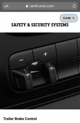

So I bought my 2017 1500 never expecting to tow ... much less across country. I have the Ram hitch and tow/haul switch but I didn’t get the factory electric brake controller in the dash.
My main question: Can I add the factory brake controller to the empty slot in the dash?
Please only reply if you “know.”

Yes you can. It's not just the switch though, there is also a control module that mounts behind the dash.
To make it work, you will have to have the dealership enable it.

“Enable” or “install” it?
I understand that the controller would be behind the dash & the slide buttons are the only thing visible. That’s the clean look I want instead of a bolt-on unit.

You can buy the ITBM kit for your truck and install it yourself. Contact the forum vendor @AllMoparParts.com to buy the kit.
You can either have the dealer enable it or do that yourself with AlfaOBD. You can find out how on the first post of the AlfaOBD thread: https://www.ramforum.com/threads/alfaobd.123982/
Depending on the dealer, it will cost you about the same to have them enable it vs using AlfaOBD, general consensus has the dealers charging an hour labor approx$150. AlfaOBD can not only enable options but can be used as a diagnostic tool to troubleshoot problems with the truck
