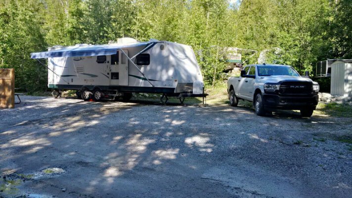

This 223RBS is 5700lbs loaded with 880lbs tongue. With the two of us, generator in the box and other stuff, I'm right there at the trucks payload of 1419lbs. I've got 1211 rear springs so there's much less sag in the rear.

I had a big trailer like that before (and a bigger truck to pull it). You know where that trailer fit? Nowhere!!! Unless you like sandwiched condo rv parks or reserve the one of three campsites in the forest campground the year before that can accommodate a full 60’ of truck and trailer in the section where the access road will allow such a unit to navigate the corners and trees…
Your land yacht works for you and your parking lot. Have fun (And watch your payload).
