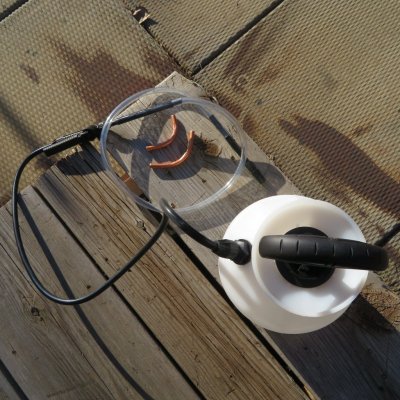

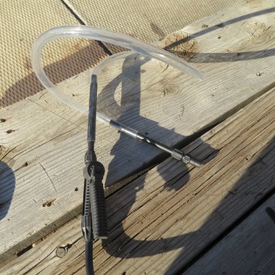

To make getting fluid back into the transmission easier,it's well worth building yourself a transfer pump like this one.
This is mine,i made up a couple differant ends for differant applications.
