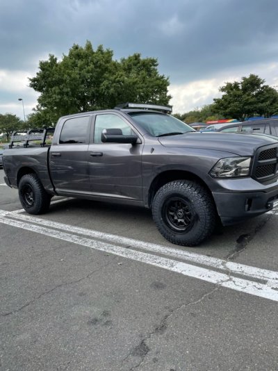

So while looking around I didn't see anything posted about this. But ram 1500 with 35x10.5r17 wheels and a 0 offset. They fit with no rubbing on a 2.5in front level and a 1in rear.
Front Level:
Mammoth 2.5in front
Rear Level:
Daystar 1in rear
Tire:
Kenda tire
35x10.5r17LT 121R D Klever R/T KR601
Rim:
Black Rhino Barstow
17x9.5
0 offset

Wrong forum. This is the 5th gen forum, and they have smaller tires from the factory (32" vs 33") and larger wheels - the smallest wheel you can fit on a 5th gen is 18" without some modification.
I had 35s on my 4th gen with stock wheels and suspension. I have 35s on my 5th gen with stock wheels and a 5" lift and still get some rub in certain situations.

The standard wheel on a base tradesman is a 17x7
