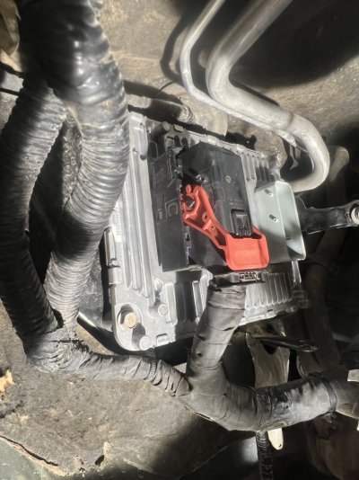

Hello names Angel , first time posting on here and was wondering if anyone might now where to find these terminal connectors (attached photos w post ) at? long story short i had bought a new unlocked diablo pcm that was matched w my vin and all that sweet stuff to be able to tune my truck with a diablo trinity.While swapping out my original PCM w the flashed one my truck threw up codes and went into anti theft mode no crank no start tried scanning for codes but said no ECU was detected . I swapped back to original PCM same thing, re connected the flashed PCM same thing But at some point after disconnecting the connectors spraying electronic cleaner spray and blowing it out with an air gun i had reconnected the connectors to PCM and she started but displayed check engine light with codes
U0100( loss of communication with the ECM/PCM "A")

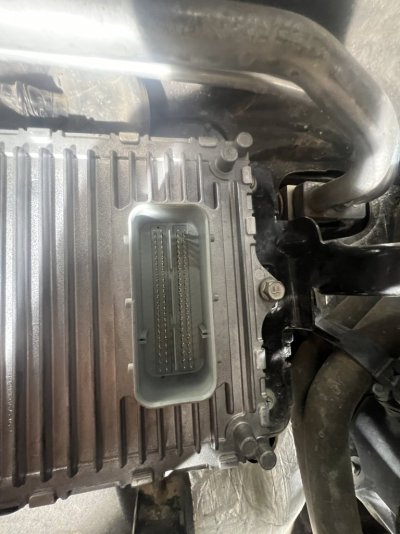

& 10140 ( indicates a loss of communication with the Body Control Module (BCM) or the wires connecting the Engine Control Module (ECM) to the BCM.) but after wiggling the connector to the right with the grey cap she went back into the no crank no start and not detecting the ECU so , i de pinned the plug and connected it to the pcm prong to see if it was loose sure enough a couple of them were so im going to have to splice with new terminal connections.

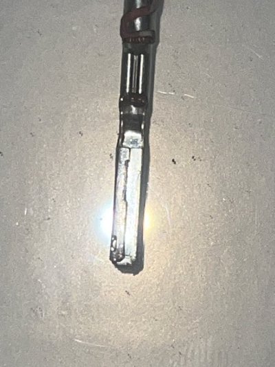

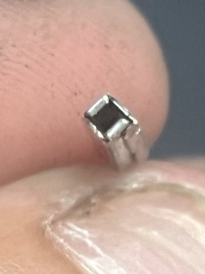

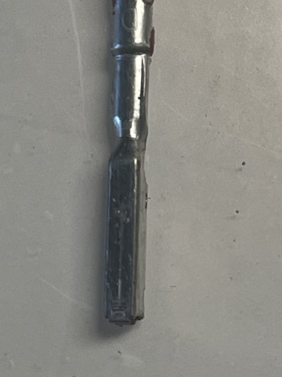

Question is does anyone know where i could find there terminal connections there’s a big variant (one shown in attachment) and a slightly smaller one , looks same just smaller to fit on smaller prong been looking and can’t find it .
