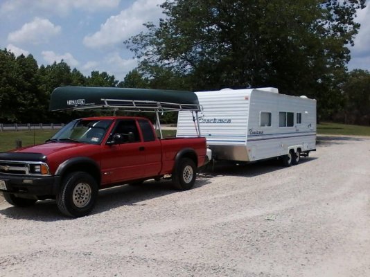

Like a tractor trailer which I used to drive, it goes by axle weights. Take the axle weights off your door jam. Thats your carrying capacity. Also lest not forget. Your tires carry the load. Make sure you have the proper load range tires.
I had an s10 chevy I towed with. It had load range c tires on it. It had a 795lb load capacity if going by axle weights. 595 door sticker. Lets just say I used every bit of that 795lbs.
The good thing with a travel trailer is the WD hitch you can throw the weight back to the front axle within reason.
I had all my trucks dialed in precise with simple cat scale passes.
**** Take your truck to cat scale. Get individual axle weights and subtract from your door sticker.
