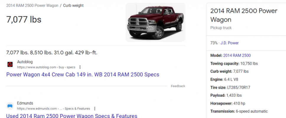

The payload is less because the truck itself is heavier.
You sure about that? 2014 PW is the exact weight of my non-PW. Payload reduces with the diesel due to weight but I'm pretty sure the reduction with the PW is because of the softer rear end.
A PW isn't really any heavier than a comparable regular 2500....maybe a couple hundred pounds. Right from the Ram website:
Power Wagon GVW is 8,565 which gives a payload of 1,560
Ram 2500 Laramie GVW is 10,000 which gives a payload of 3,130
Just to clarify, the GVW is NOT what the empty truck weighs but rather how much total weight the truck can handle. As said the higher the GVW rating is for the same basic empty weight truck, the more payload it can handle.
If you run the numbers those are assuming a PW weighs 130 lbs. more than the Laramie when empty, but there is a 1,560 lbs. payload difference. This is basically saying the non-PW 2500's can haul 1,500 lbs. more payload.

The power wagon has softer springs so you will lose some payload. They are also about ~1.5" taller so you may need to swap the shocks as well to accommodate the slightly longer reach.
The actual weight difference between the PW and a similar 2500 is negligible, it's payload is reduced because of the softer springs.

When I bought my 2500 cc 8' bed, I looked at the comparable PW. It was almost the same exact base weight. As mentioned, it is the set up (springs, higher ride, etc.) that causes the PW to have about 1/2 the payload capacity of my truck. I was bummed when I saw that, always wanted one but can't have a HD truck that as designed tows/carries like a 1500. But they sure look good!
