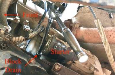

First a big thank you @Hemi395 for the write up! I was able to follow it quite closely for my 3rd Gen 2009 Ram 2500. Thought it could still be worth sharing my experiences, so here goes.
First, I just bought this Ram with about 105k miles on it. Wasn't sure when the coolant had been done last, but since it's 5 years or 100k miles I figured it's due. When draining the fluid out of the radiator petcock it looked brand new; that's a good sign right?! No rust or funky colors, just nice bright coolant. Based on that I decided to skip the distilled water flush and just do a drain and refill.
After draining the radiator I removed the heater core hoses, then the lower radiator hose (at the water pump), and then went for the block drains. I did not remove the t-stat since I wasn't doing the flush and it didn’t seem removing it would get any more coolant out. Taking a bit of a gamble that the t-stat is in good shape…
Passenger side block drain was easy to get to, but not easy to get off. At first I thought the 14mm socket was a hair too small. But with a good cleaning and some tapping on the socket I got a good fit. Also took a lot of umph to break the plug loose.
On to the driver's side plug. It looked to me like I might be able to get to it with a wobble extension. Not sure how different my 3rd Gen 5.7 (or the layout of a 2500 for that matter) is but I was JUST able to get everything on. Here’s a photo:
Again, quite difficult getting the socket seated on the block plug. With patience and persistence I got the socket fully seated and the wobble extension on. Took a lot (more than the passenger side) to break that one free, probably due to the loss of toque through the extension?
