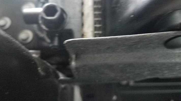

Drain the radiator: Take the radiator cap off and set it aside. Attach the 1/4" hose to the drain nipple and feed it into a container. Rotate the petcock counterclockwise using the 3/8" allen socket until it opens completely. You will hear coolant start draining into your container. The radiator holds about 2 gallons of coolant so plan your containers accordingly.

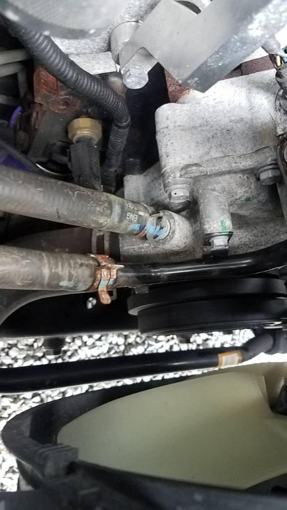

Locate the heater core hoses at the bottom of the water pump. Remove both from the water pump noting where they attach to. Be ready with a drain pan under it because all the coolant in the heater core will flow out. At this point I took 12psi of compressed air to one heater core hose to completely blow out any remaining coolant. This isnt really necessary as most of the coolant flows out on its own but it doesn't hurt to do. DO NOT USE MORE THAN 15psi of air! Replacing the heater core is a big job that involves removing the dash and HVAC assembly.

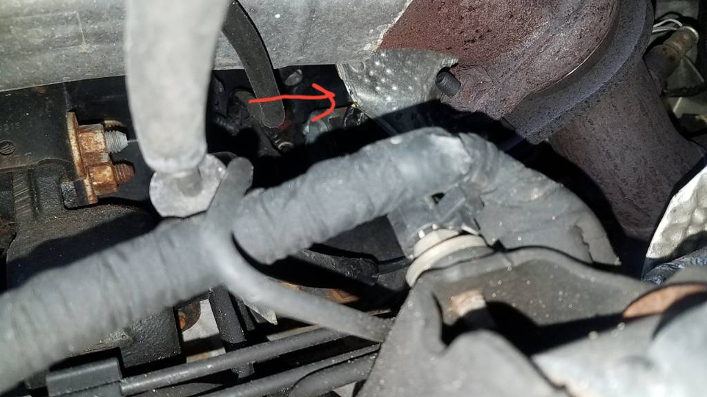

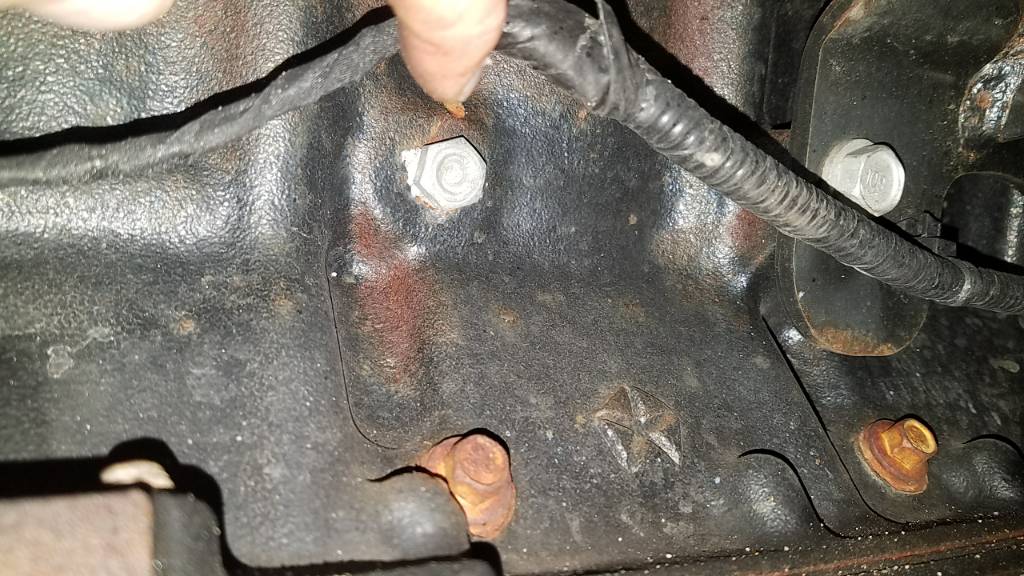

Next comes the fun part, the block drains. The passengers side block drain is perfectly visible. Remove it slowly and allow it to drain slowly. If the whole plug is removed you will take a shower in coolant. Trust me, not fun. The drivers side block drain is perfectly behind the starter and front diff bracket. I didn't have any tools that would fit in there at that angle so I wasn't able to drain the drivers side of the block. If anyone can figure that out please post what tools you used!

Heater core hoses on the water pump
Radiator petcock
Passengers side block drain
View of the passengers side block drain plug from the wheel well
Best view I can get of the driver's side block drain
