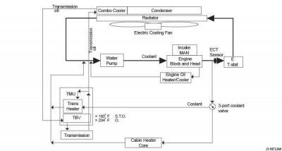

I found a pic diagram of the EcoDiesel cooling system, I would imagine the gassers are similar as you have the 3 way valve and transmission heater.
A brief description of operation:
Coolant not required for cabin heat is directed to the transmission heater. Coolant flow is directed by a pulse width modulated ball valve located upstream of the cabin heater coolant supply. Coolant first goes to the 3-way valve inlet port. The coolant valve receives a signal from the engine controller directing to turn the ball valve in accordance with the heater demand. The transmission heater is an assembly containing an oil-to-water heat exchanger and a thermal bypass valve (TBV). The coolant that is sent from the 3-way valve warms the transmission fluid in order to get it up to the ideal operating temperature.872B4FAD-7621-41BB-B7D3-94ED884FBB97.jpeg

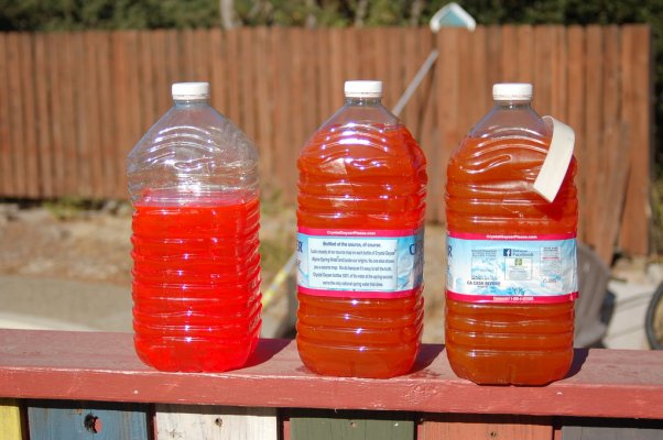

So first pic condition of 9 year old HOAT coolant that has a 5 year lifespan. As you can see by the color it is not advisable to put off this item. So the two bottles on the right is what came out of the rad and over flow, and the middle bottle is the exact left over of that and the black bottle behind it which I diluted with distilled water. So if you were a fan of die hard two, that is almost exactly what was taking out, thus you wont need to burp ****, about the only bonus to doing a quick flush.
Bad choice for soda while working, and basically shows up close difference in coolant color aged from new, but this new was 100% not mixed with water yet, but that doesn't change the color.

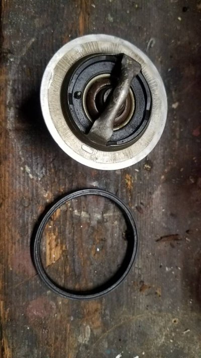

Next go to the thermostat housing. This would be a great time to change your thermostat since you will be taking the housing off the water pump. Loosen the bolts on the water pump and remove the housing from the water pump. Remove the bleeder plug next to the thermostat housing using the 1/4" allen socket. Pry the outer gasket off the thermostat and reinstall the housing without the thermostat but with the gasket in place. This will ensure water flushes through the entire block.

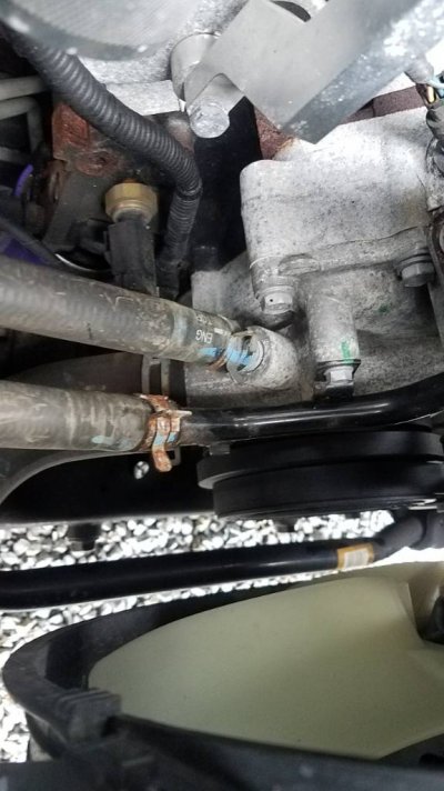

Locate the heater core hoses at the bottom of the water pump. Remove both from the water pump noting where they attach to. Be ready with a drain pan under it because all the coolant in the heater core will flow out. At this point I took 12psi of compressed air to one heater core hose to completely blow out any remaining coolant. This isnt really necessary as most of the coolant flows out on its own but it doesn't hurt to do. DO NOT USE MORE THAN 15psi of air! Replacing the heater core is a big job that involves removing the dash and HVAC assembly.

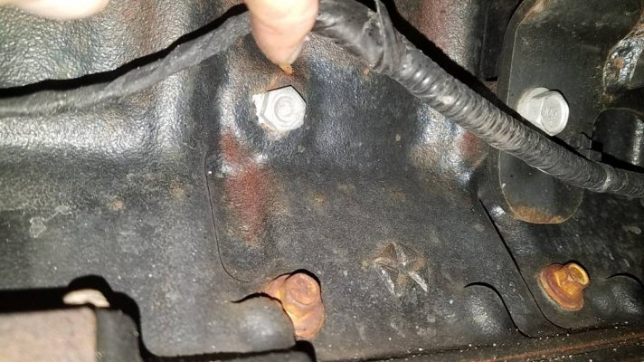

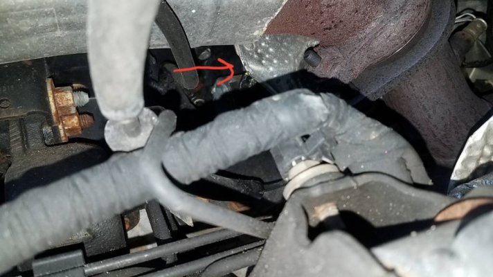

Next comes the fun part, the block drains. The passengers side block drain is perfectly visible. Remove it slowly and allow it to drain slowly. If the whole plug is removed you will take a shower in coolant. Trust me, not fun. The drivers side block drain is perfectly behind the starter and front diff bracket. I didn't have any tools that would fit in there at that angle so I wasn't able to drain the drivers side of the block. If anyone can figure that out please post what tools you used!
Once you're satisfied that all the old coolant is out (with the exception of the the drivers side of the block) reconnect the heater core hoses, lower radiator hose, and put in the passengers block drain plug. Leave the bleeder plug on the thermostat housing out for now.

Heater core hoses on the water pump

Passengers side block drain
View of the passengers side block drain plug from the wheel well

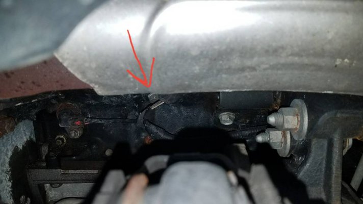

Best view I can get of the driver's side block drain
Removing the thermostat gasket temporarily

left to right, new coolant, 2nd flush, first flush. I will try and find a pen so I can label old bottles. More coolant coming from the Amazon jungle, will be a couple days before I get to another. Goal, come close to factory color. If you ever seen how fast coolant flows, it doesn't take that long for the coolant to dilute itself but good. I am considering see if I can flush with t stat open, it would be hit and miss as the t stat doesn't stay open and I'm not sure if it closes automatically when power is turned off. So dunno, maybe I keep flushing cold.

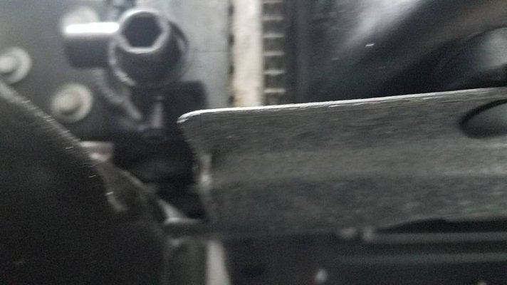

Bottom, you can use a wrench on the rad petcock but not a socket, you can see why. You have to take the top not behind the t stat every flush or you're shooting yourself in the foot. Soon as you take of the top not you see flow coming from rad. Stay tuned to see how many flushes it takes to get to the sweet spot.
