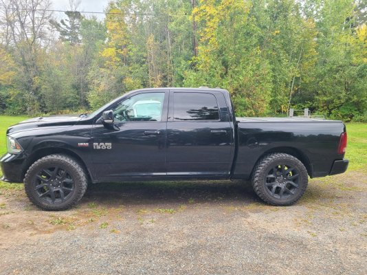

I have a 2014 ram i have swapped 2022 ram rebel diffs and suspension into but the abs signals between years is different. So all my traction lights and speedo are inop

How are the wheel speed sensors currently hooked up? Do you have the 2022 wheel speed sensors still installed and did they plug into the factory vehicle side connectors? Did you install the 2014 wheel speed sensors into the 2022 hubs?
The 2014 and 2022 models show different part numbers for the wheel speed sensors. While the sensors don't really change the signal (they are just reading the tone ring), they could be wired differently or if you mix matched tone rings and sensors they may not be gapped properly.
Also not sure the number of teeth between the two models.
Have you hooked up a scan tool and can read live data to see what the signals look like? What are the specific codes showing?
There is a lot of basic information that is needed before anybody can even start saying what is needed.

So the only parts is the 5g front hubs installed into stock 4th gen spindles and the rear 5g axle shafts installed into stock 4th gen axle housing along with swapping tone ring to the 4g? Then modified rear sensor bracket?
