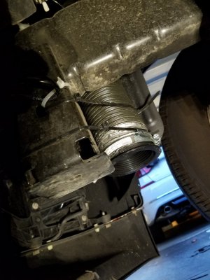

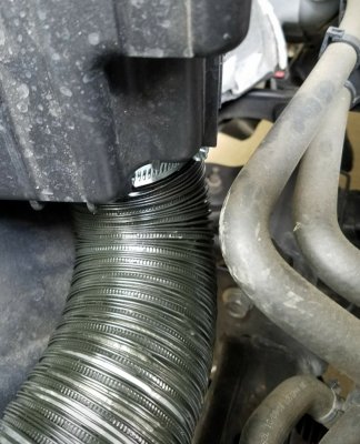

On my 17 its just straight down secured to bumper bracket. I have a clamped on fitting on end with a piece of screen for additional filter of sorts. Sorry no pic of end behind bumper
