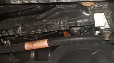

Hello All, chri5k is correct, the whole issue with the drag link is the TURNBUCKLE !!. It appears when some of the turnbuckles were machined the hole was oversized a few thousandth, then when the threads were cut they wound up being to shallow allowing the drag link ends to jump threads inside the turnbuckle, hence giving the illusion that the jamb nut(s) backed off when they had not. The nuts are good so they are using them as an extension of the turnbuckle by doing the welding.
The big problem is FCA does not know when this screw up happened.
I agree this should only be a temporary fix till FCA supplies the new draglink. Or you replace the draglink or turnbuckle and provide proof of said fix to FCA, at which time they should reimburse no questions asked. But we know how that goes.

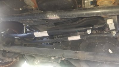

What is the difference between the old and new drag link? What changed?
Thanks,
BillyGoat
Dec 21, 2020
77
48
SE MI
Cool, thanks. Looks like a much better design similar to the synergy link. This should be a no-brainer for FCA to replace all those affected... total BS
