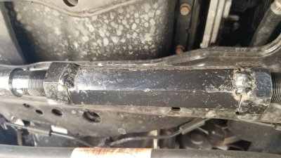

I just bought my 2018 2500 last month. Checking the VIN# shows it was "completed" Jan 2019. How do I find out whether it was welded or replaced? The chassis was undercoated, so even if I crawl under there, I doubt I would see a weld. The truck wasn't bought from the original dealership. Would any dealer be able to look up what was actually done? It's bugging me now.
It will look something like this. See the bead of weld on the one flat of the locking nuts?
You would know welded or not. Post 160, this thread, shows the old link. The redesigned link is here: https://www.ramforum.com/media/draglink.28737/

2018 - 2500
18Crewdually & SeppW - Thanks
Yup, mine's welded
