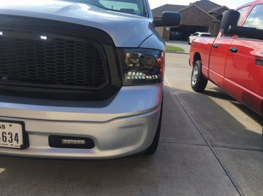

i have the ones with white LEDs in them and an all black housing...
and with HIDs the visibility is very good, comparable to the MH1 and yes wont be as good as the FXR, but these are nothing to complain about
but in less than 24 hours im already having problems with the LEDs in the passenger side headlight :mad:
so honestly id say keep your money and dont buy them, not while they are still new

what problems?
the some of the LEDs started to flicker in the parking lights, so im not very happy with that aspect of them, but otherwise they are nice, good fit, clean look and great visibility, just the whole LEDs screwing up is kind of killing it

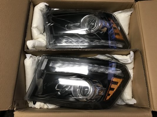

Just so everyone knows, the clear corners that you can order for this style of headlight, WILL NOT WORK IN THESE, these have made up their own mounts and they dont share any mounting points with OEM nor TYC replacement parts...
i have 2 sets of these and have already taken one apart to inspect it

i didnt have one to try and fit in there, the wiring part is pretty much compatible in anything, but im not sure if they will fit the same in place of the turn signals that is in these, that you will be taking the risk on, my plan was to remove the amber corner and replace it with a smoked clear one, and once i removed the amber one in these i noticed real quick that it wasnt the same, so i had to do a bit of custom modifying to make it stick and its not even a great fit at that...

First, I drilled 7/8" holes in the back of the light housing adapters using a step drill bit (Harbor freight). I then used grey RTV to make a true weather seal around the wiring. You will note that these HID bulbs are separate from the wiring (The cover on the right, the two wire connector attaches to the back of the HID bulb the other two male connectors attach to the low beam connector):
Here are the light housings waiting to be installed. I already installed the HID bulbs, put dielectric grease for ease of future connector removal, and put the covers back on. Here they sit with the manufacturers scratch protecting covers:
Next step on Saturday is to remove the factory Quads, install the HID Can bus wiring harness, then install these.
