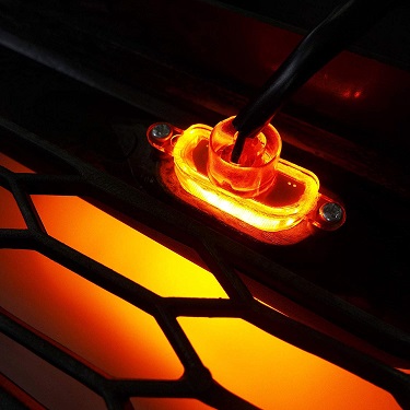

I wanted a new and mean looking front grill so I purchased the Rebel Style off Ebay.
I am not really liking the amber lights after looking at them. I have been searching for replacements in a white LED but have not found any yet?
Can someone help to point me to a source? Thanks for any and all replies.

Try to contact Johnny at LED Innovations. He might have something that would work

You can just buy 3 individual leds with the wire leads on them and then mount them into the holes where the amber ones where and then hardwire them into the wiring harness on the grille that’s there for the amber ones. 3 individual less can’t be more then a dollar. They sell packs of 20-50 on eBay for like $9. They come with the red/black +/- wires on them so they are super easy to wire up. They also are the kind with the plastic (glass) cap over them so you can use them outdoors.

Will look into that. Am looking to switch them over to white but these will do for now.

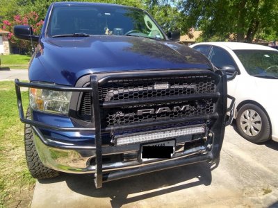

In the mean time I went ahead and mounted the grill in my truck. I took it back off when I realized I couldn't read the RAM logo with my Ranch Hand grill guard. While I had it off I decided to shoot it with the extra Upol Raptor black I had and it turned out great! Now it is well protected. Will get some pics up tomorrow I hope. And since the RAM logo didn't work on the grill, I mounted them to my grill guard! Now it stands out real nice.

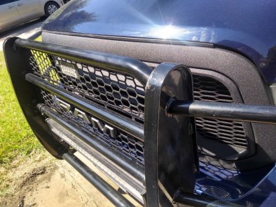

With the Upol Raptor on the grill. Love the texture on it

Pretty badass, also nice innovation on relocating the Ram emblem. May I ask where you purchased the grill? Thank you

First off, thanks for the positive comment! Appreciate it.
Got the grill off Ebay for $134. If you want the link I can get it for you.
Reason I shot the Raptor liner on it was like others have said, the grill itself is a hard plastic. Hoping the Raptor gives it some more strength and protection. And it looks great to me!
I used Upol's new 2 part liner in an aerosol can. (U-pol 4883 Raptor 2K Aerosol Truck Bedliner Protective Coating)
2 cans were used to cover it up good. After shooting it with their U-POL 0799 Grip#4 Universal Adhesion Promoter.
Was thinking about doing the RAM badge in red Raptor so it stands out!
Will have the lights wired up and working by the weekend.

The liner definitely gives it a more rugged look too, with the amount of dirt, road rocks, and bugs, that was a wise move. Will take the into consideration when I get mine. Thanks again

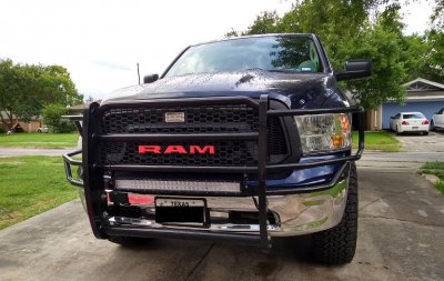

Saw some others with the red RAM badge, so I Raptor coated mine with flame red and love the look!
