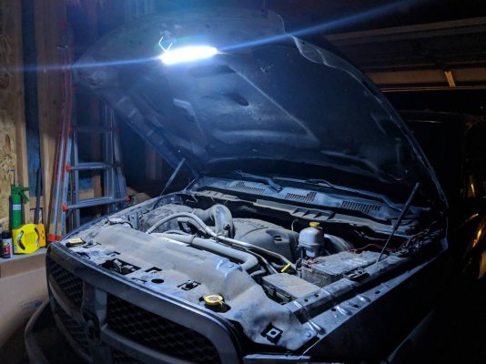

I wired mine with a pin style switch that came with the kit. I even used a factory hole.
I've been in plenty of rain and snow and salt, and, no problems.
Here's a link to the kit I got, highly recommend it.
Check It Auto - Under Hood LED Light Kit - Automatic on/off https://www.amazon.com/dp/B00FW1K12Y/ref=cm_sw_r_cp_apa_i_x3.DCbKQX6H02
Picture of the switch it comes with:

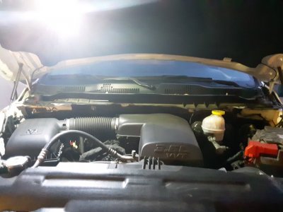

Wow! I got the twisted LEDs that I ordered from the link above and installed one. Quite a substantial difference!
Before and after.
