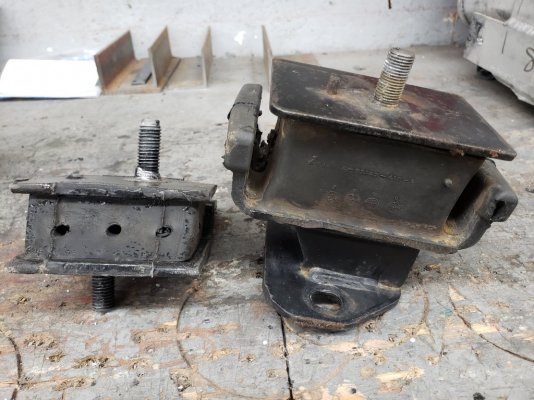

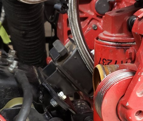

Pulled the engine back out last week to build new mounts. I had used the Dodge 6 cylinder mounts and modified them with cross drilled hols as others have done with the 4BT but still way too much vibration. I had these Isuzu NPR box truck mounts sitting on the shelf and they should be much better. The Isuzu engine is about the same weight as the Cummins. Just kicking myself for not using them in the first place. I thought they were too tall but in the end they work better than the low profile Dodge ones.Rambo mounts.jpgRambo new mounts.jpg

Not much new to report. I'm currently away on holidays with the truck and my 5th wheel but it was only a 3 hr tow and performed very well. The new engine mounts have made a very nice differences to vibration which you dont notice at all unless really looking for it at idle. I did add an electric vacuum pump just before heading out as a backup to the belt driven one on the engine just to have the piece of mind that if the belt broke I would still have brakes. :) Did the heater core and AC condenser so should not have to worry about that when on the road. If all goes well we plan to be on the road 5 months next year across Canada and back through Northern US.
