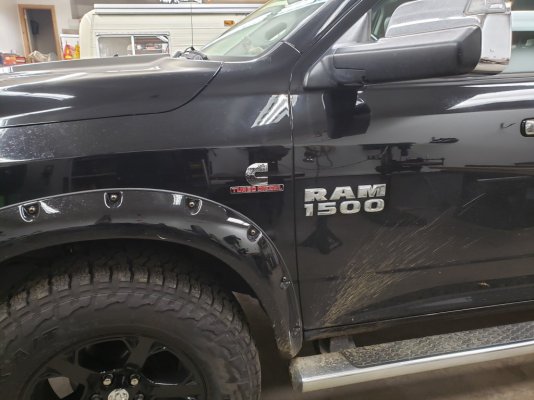

I suppose if you like to be unique and I do, this is one reason to spend an obscene amount of money swapping the truck.Cummins emblem.jpg

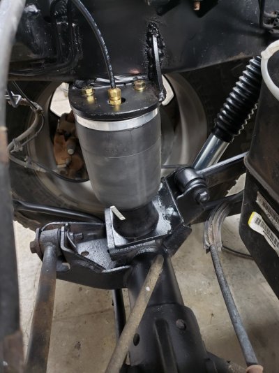

After fighting the factory air suspension for a year I decided to upgrade to the Bilstein shock/strut setup.

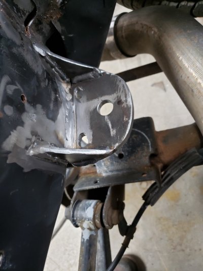

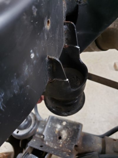

That left me with no rear air setup that I really like for connecting to a trailer. After looking at ALL the aftermarket options I decided to build my own. The reasons I went for my own design are: wanted to be able to drop the rear at least 2" lower than stock for connecting to a trailer and raise the rear 2" higher than stock for a bit of lifted look.
Most kits gave me the ability to lower OR raise but not both. I started with a pair of 2" lowering rear springs so the truck would sit lower with no air for connecting to a trailer. Then made brackets to support the new Firestone 9002 air bags which will give me 2200lbs of load capacity.
I used these same bags on my Cummins Dakota and they worked fantastic, I also put 4 of them under the back of my RAM 3500 deck truck for dropping the back of the deck for loading.New upper bag bracket.jpgOld bump stop removal.jpg

I know, crappy welds but they usually work. The plates go all the way under the frame and are welded on the other side as well. Almost half the bag sits under the frame so should have good support. I will use the old air suspension sensor links to add limit switches to let me know if the bags are too low or too high.

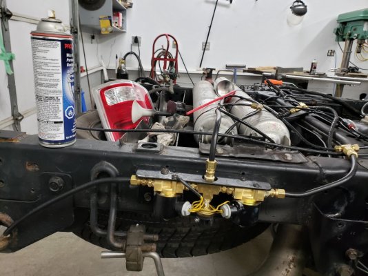

A little more done on the air bags. Bags are in and the system works very well. Used the two old original air tanks along with the 2 gallon one I had previously installed for the air horn so lots of air.
The up and down solenoids will be operated from both the cab and rear bumper. The bumper switch is nice when connecting to a trailer and something I loved on my Dakota. I put 2" lowering springs in the rear so the truck would squat lower than stock for connecting to a trailer and then the bags would bring it back up to ride height.Air bag valves.jpgRear air bag.jpg

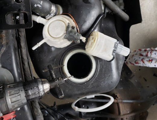

The fuel vent system does not work well with Diesel, too slow to fill. I removed the old vent system and building a new one. Got the old plastic housing out and machining a new aluminum one to replace it.Rambo fuel tank vent removal.jpg
