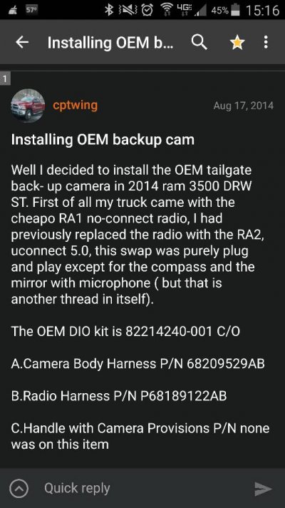

There's an old thread on installing the OEM Backup cam kit .
This is located in 4th Gen Audio and electronics.
Lots of good info in this thread .
A MUST READ IS MPGRIMM2 POST # 10 AND IT'S REFERENCES! !
Sorry don't mean to yell , but Mpgrimm2 s post # 10 covers all you need to know and his quick ref. Links could save you some frustration.
The install itself is a pretty easy DIY a 4 out of 10 .
There are a couple areas people do tend to get confused , @ any point in the install of your OEM kit if you are not 100% confident simply refer to Mpgrimm2 post # 10 or PM me , or post you Qs and concerns in the thread by cptwing installing the OEM Backup cam kit . Myself and others are monitoring that thread !
I doubt you'll be able to beat the cost of the OEM kit purchasing things separately.
Hope this helps !
