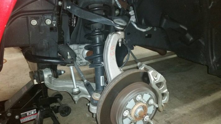

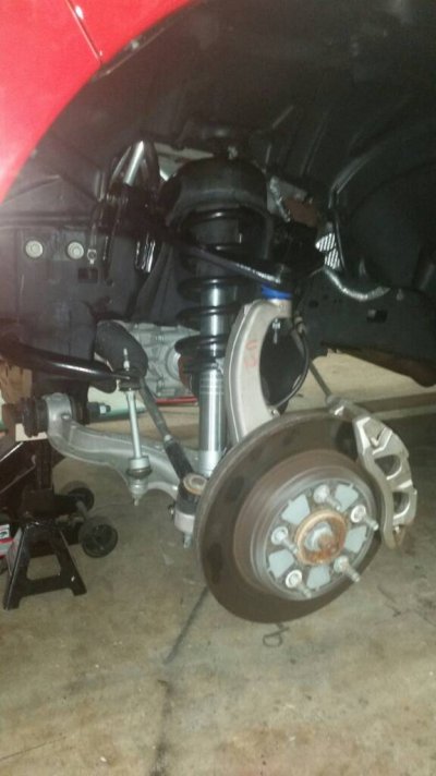

My pics below on Bilstein install.
Stock set up.
Oem UCAs & OEM Shocks removed .
Aftermarket UCAs &Bilstein @ +2.8"
