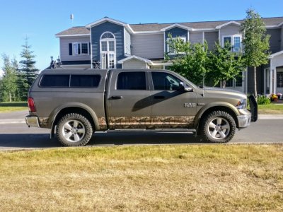

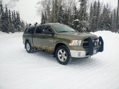

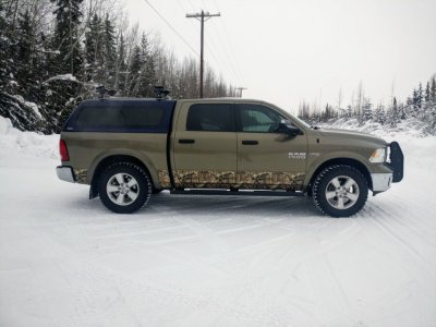

I know, I know... Everyone's pro Bilstein... And there's nothing wrong with that. The Ranchos just appealed more to me. 90 minutes start to finish with only hand tools so it's very easy. I could find very few photos of 4th Gens with these so I thought I'd contribute just in case it helps someone else. Tires are 275/65R20 Cooper STT Pro's. Nothing done to the rear and no wheel spacers. Ride has been great so far on #7 setting.

Thanks... It's definitely grown on me. Once spring gets here I'll paint that topper and be much happier with the looks.

No issues with uneven settling after 4 months. I'm pretty sure everyone jumps on the Bilstein bandwagon because they are cheaper so more people use them. Herd mentality to an extent IMO but I understand wanting the adjustability. I never measured before or after cause I really don't care. After researching I knew these would lift the front effectively and leave a small rake which is exactly what I wanted. If I had bils they would be set at 2.1 No regerts here! ;)

Thanks JohnnyMac! Drove around with the blue topper for 2 years but I'm so much happier now that it's painted. I noticed I'm actually up on the raised lip of the curb with the front wheel a bit which compressed the suspension slightly, so there's actually less rake than that photo shows.
