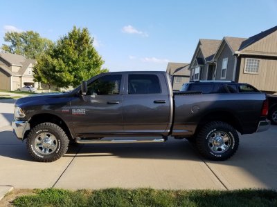

Got the pro's on mine in 305 70 18 and they are wearing great. Got over 11k on them and rotate every 5500 miles or so. I'd estimate I'll get 40k off them at the wear so far. They have gotten loud though, but I like the noise. I think less miles between rotations would quiet them down. Rotated them a week ago and they sure got loud from that. I also have a 2 inch level.
