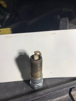

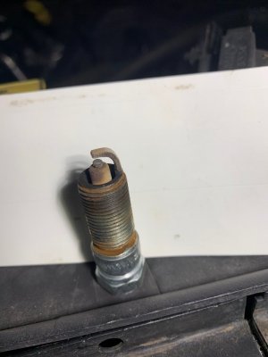

Again today I stopped at a store for about 15 minutes, came out to start my truck (completely warmed up engine) and it did the tick again for about 10 seconds. The engine light came on this time. Got home and checked the code, p0306, cylinder 6 misfire.
No matter if it’s ticking or not it idles smooth and drives fine.
I pulled cylinder 6 plugs, replaced them and swapped the coil with cylinder 2 coil, reset the codes and I started twice with no ticking.
Being random and it goes away after 10 seconds could this still be an internal issue? If this is an internal issue can more damage be done by continuing to drive it, could be a week or two before a mechanic can look at it.

I changed the plugs. Two warm starts with no ticking. 45 minutes later had ticking.
