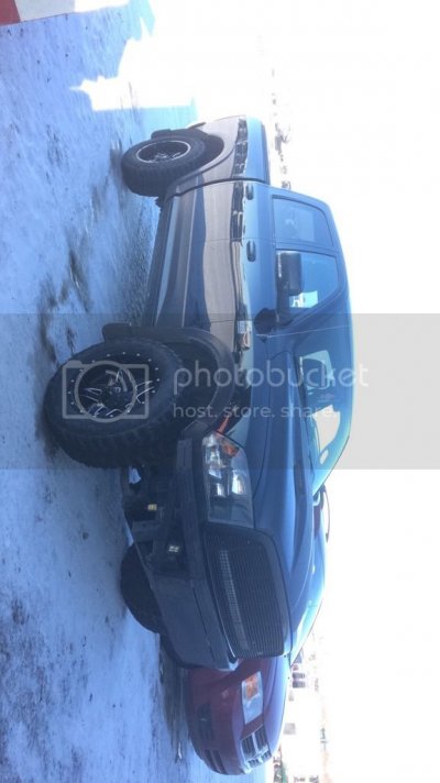

hey guys! Looking to possibly raptor line my 2012 ram. Truck is currently black so will just be sticking that colour. I’m trying to convince the wife. She doesn’t like the textured look but it’s not her truck so that’s not a big deal. Her biggest concern is re sale value. I’m also not overly concerned with that either. The truck is already scratched and has a few small dings. So I’m here to ask what you guys think? And would love to see for 4th gens that are done already! Here’s a pic of my truck currently!

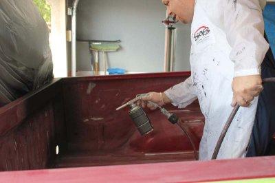

Here is a close up of the kit.
And just be advised that, bedliner isn't just sprayed on and it's all done, one color, one sheen and looks good. You still ABSOLUTELY need to know what you're doing. You get one spot too thick and the others thinner, you now have a spot that looks horrible.. will stick out more than a ding in a door..

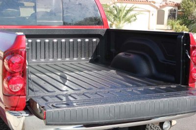

AH! Found the pictures. It's DEFENDER PRO! That is the best one I liked. It laid down perfect!!
Though this was probably my 20th time laying down bedliner, finally got it right ! :)

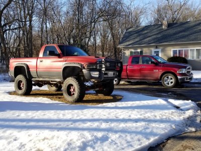

Are you talking about doin entire truck or just bed? If entire truck I don't think 2 gal will be enough for you. I sprayed my entire truck few years back with 2 gal of black scorpion liner and 4gal of red. Still glossy everytime I clean it. Only issue is I do have some rust coming thru but it was almost 15 years old when I sprayed it so truck was already rusting. Fixed it best I could with what I could get my hands on.. this was back when I was in college. Other than that it is holding up well20180216_154728.jpg
