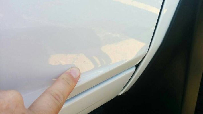

- Right Front Door: Not sure if the paint shop tried to buff it down/touch up the bubble or what was done, but I could see some of the primer base/metal where the original issue was (thin paint?). Also had a very distinct primer base/metal edge along the bottom of edge of the door panel (probably at the tape line) that was likely going to rust quickly with the rain running down at the bottom edge.

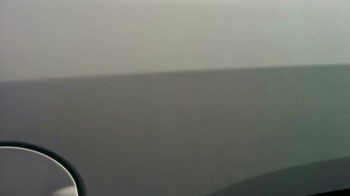

- Left Rear Qtr: Paint shop took care of the original issue. However, there was a very distinct tape line/edge along the entire top bed rail that someone tried to hide under the bed rail cap that was not blended in at all. I noticed it right away because it was sticking out about an inch from under the bed rail cap. Also had visible paint mist/spatter on the lower front 1/2 of the panel that appeared to be where the shop was blending over to the original paint. This area was smooth/apparently under the clear coat. Leading vertical edge of the qtr panel at the cab had the same issue where the surface was rough and paint wasn't wrapped around it.

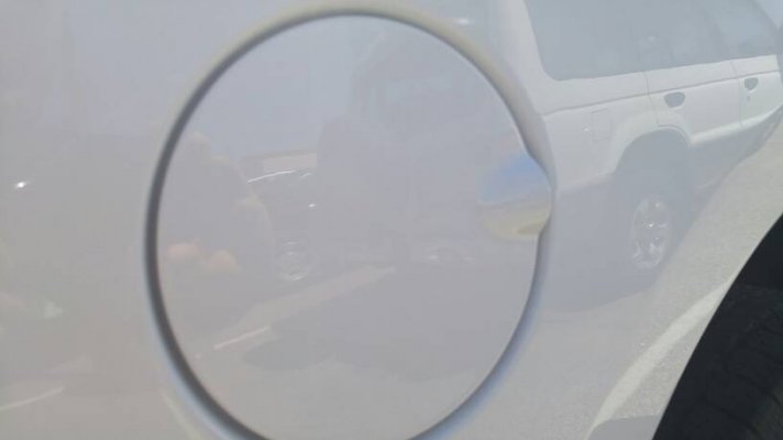

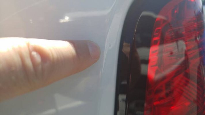

now there is a spot at the rear taillight with debris/grit underneath it (similar to when I started this process) and also about 8-10 separate bits of debris/grit under the paint on the Gas Door Cover
(Can't really tell from the picture)
