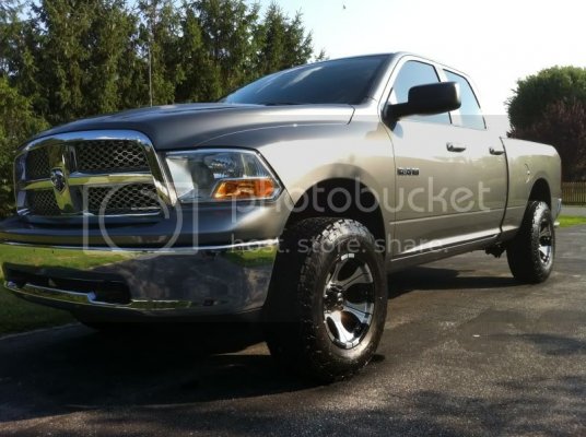

i had the RCX leveling kit on my truck a while ago and just a little hint from my experience, if you put the rear spacer in your truck still wont sit level, just higher all around. heres a pic of mine with the same kit on....see how the rear sits higher? id just install the front spacers if you want it perfectly level. it is an overall nice kit though. didnt affect my ride quality at all. just trying to help!

yea they really shouldn't call it a leveling kit. Honestly your truck still looked good with it installed. A slight rake looks good imo, but the stock rake is horrible

thanks, and yea it wasnt the most noticeable rake in the world but definitely noticeable looking at it straight on from the side like that. heres another one where you cant tell (i really dont miss those quads lol.) and if i remember correctly my kit was a 2.5''/.75'' versus his with the 1.75'' rear. is that how it comes now? or is that a typo? hope all this helps OP.
