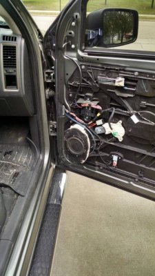

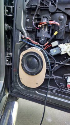

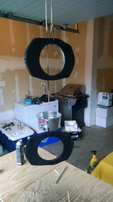

Heads up to anyone making their own baffles 3/4in MDF won't fit behind the door cards

Nice....Thanks for teasing me with your sweet baffles....
Seriously though, they look great. Nice work.

I can't get 1/4 but if I could I would use that. Half inch will work but I think I should have recessed the speaker a bit. I'm not too worried with these but the 6.5s that I'm looking at doing will need all the available room they can get with their xmax.

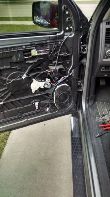

Got those little ******** in and now either wait till tomorrow for audio stores to open up or go find some peel and seal

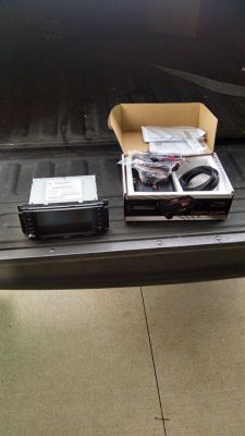

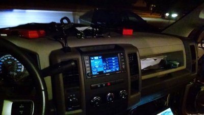

Started out looking at it wondering if i had time to get the touch screen and dsp in today.
Well its not pretty but got it in in a few hours.

Oh damn! This builds getting real! Lol
Radio looks like it belongs there. Lol. Now how do you post this and not tell us how it sounds? You get any chance to tune?

Thanks man thats all I wanted was something there that looks like it belongs. I only got a chance to set basic xover points so really I can't say how it sounds but seriously the PPI program is one of the easiest I've used once you get past the initial setup of how you are setting up channels.
Now going to get more roadkill and shorter rca's install those get the MLV up on the doors. That vinyl is a pain to hold into place by yourself lol.

Hear u in the mlv... Zip ties are your best friend. Those plastic "Christmas tree" door clips worked wonders too. Just drill a hole and push em in
