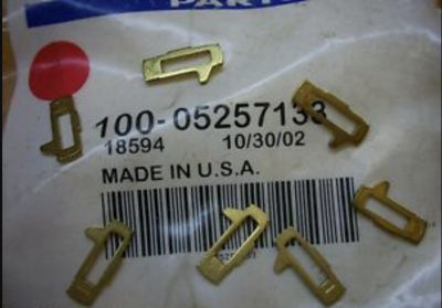

So I have the kit you pictured above (68211624AA), but there are no tumblers in the kit and no instructions. Only this:
davepen
davepen
Apr 15, 2014
42
W. St. Paul, MN
2010
6.7L CTD
Okay, now I get it--these are what I'm missing (maybe not the exact p/n):
I can send you the kit I have and $4 for the lock you mentioned above if that works.
Thanks.

I have the tumblers and springs. Just need the pic of your key blade. I will send a PM (Conversation) with my PayPal and mailing address.
