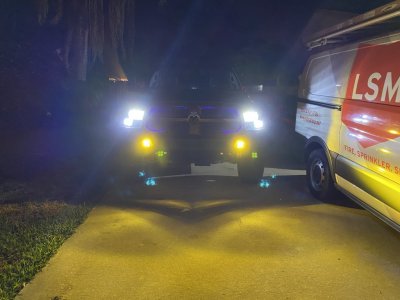

Im sure a lot of people with lifted or leveled trucks forget to re-aim the headlights and fog lights. I’ve readjusted both on my truck. Plus I’m running pod lights for my fog lights. They are SAE/DOT approved lights for use as on road fog lights.

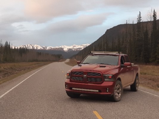

I'm not legal by any means but I sure can see when I need to. The thing that keeps everyone from bugging me is mutual respect. One set of lights on when coming at traffic unless ur a weisel then you get more as needed. [emoji6]c5146d08aa8814e6ee6d6697ba0d8d9a.jpg
