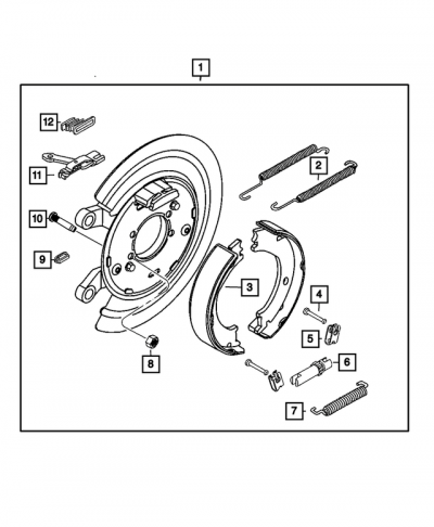

Sounds like you've done plenty to try to resolve it. I agree these things can be really annoying. I don't know what all you've done, ...so I'll list off a couple things come to mind, per the illustration below:
1) Cable - When you had the system apart, did the cable move freely? Like really freely? Is it possible the cable is partially catching somewhere further upstream?
2) Lever - The lever actuator assembly (#11), was it pretty rusty? I would suggest removing it and greasing it. Sometimes they can get rusty and hang up just enough to not *quite* spring free. At the least make sure there is good grease on the rubbing surfaces. If you did those things, you might consider replacing it.
3) Wear Ridges on Backing Plate - How did the backing plate look? Where the shoes fit against the backing plate, sometimes wear indentions can occur (in the backing plate) and the shoe can't 'get out' of those indentions. Indentions can occur from rust too. If there are indentions, consider carefully working smooth any edges with a dremel or a small grinder. Put a daub of grease on the wear points.
4) Sufficient Spring tension? - Are the springs in the right spot ..so there's enough tension?
5) Test w/o Cable - You could assemble the whole assembly w/o the cable, then actuate the lever with a pliers and go back/fourth a number of times to see if it releases properly ...or catches. If not, it could be in the cable, or further upstream.
6) Compare against the opp side - If you still don't see an obvious issue, You might pull off the cable from the other brake and inspect that. Just in case the cable (or lever actuator) on the other side is the one hanging up ...but affecting the side you've been working on.
I'm sure you've checked some of the things I listed .... hope these help.
