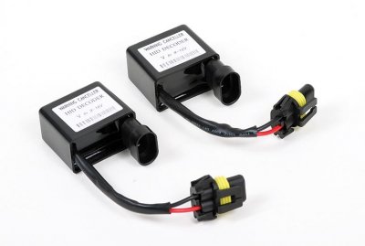

Buy a $10 error code eliminator. They worked on my cheap Chinese his kits on my '13 and '14.

In all my kits I just ran a 35watt cheap hid lot from vvme.com with no extra harness and ran an error eliminator on both sides.

Need either canbus ballasts, anti flicker capacitors as shown, a canbus relay harness or anti flicker/warning eliminator adapters, jj at the retroshop can get you up and running
Post your results, I bet this will cure the flicker issues :)
x2. That is all you need.
I run some HIDs I've had for over 5 years. wiring harness and anti flicker eliminators. Not one single problem.
