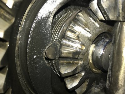

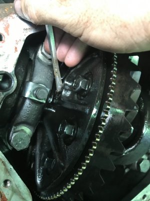

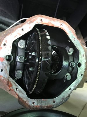

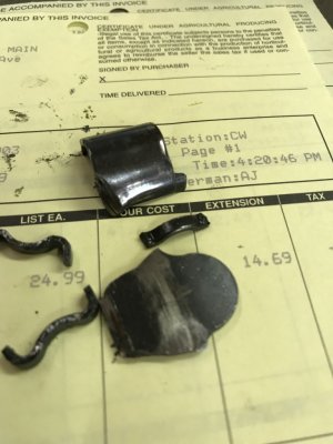

Upon taking the cover off I noticed I have broken parts laying loose in the housing. Obviously I have no idea how long it's been like that since it's never been changed before. Should I say hell with it and drive it or should I take it the the shop and have the rear end fixed? It drives normal, no noises.. I took some pictures of what's broken.

What you have there is a broken Trak-Loc clutch retainer. I cant even count how many I have seen like this. It is a very common occurrence in the 9.25 Corporate Axle. Normally what happens is the owners do not catch it in time and the retainer gets caught in between the diff case and the bearing side cap and the retainer machines a large gouge in the bearing cap and sends metal shavings throughout the diff. I have pulled these broken clutch retainers out and cleaned the rear diff with brake cleaner as best as possible and sent them on down the road. I have done so many like this for customers who didn't want to spend the money. I actually have one in a 2005 QC of mine. I removed it under a warranty repair and installed the diff case with the broken retainers into my truck and it has survived for 8 years without a problem.

Here's what will happen...someday. Tomorrow, next year, in two weeks...
Your clutch packs will start to disintegrate, sending a shower of fine metal particles throughout your fluid. The magnet that caught your clips will hold some of it close, but eventually there will be too much metal for it.
The metal contaminates will work their way into every bearing, scoring the rollers until you have metal to metal. The too small pinion bearing is the weak link. It will warn you of it's eminent passing by an increasing roar until the defiled rollers explode from the bearing cage.
The carnage is usually spectacular, and can stop you dead, locking the rear end and spinning you around. Or it will fail at a stop light and leave you stranded. Attempts to force movement can cause your transmission planetary to explode as well, leaving you with an even larger repair bill. I know this from bitter experience.
If the truck is of value to you, consider a rebuild, replacing the weak clutch packs with a Detroit Tru Trac differential or some form of locker. If the value is less, replace with a lower mileage axle, or rebuild what you have and expect things to go South at some point again.

There is no real definition of how long the diff will last. It is all just speculation. You will eventually lose the limited slip function of the rear diff. The clutches will start to slip but there is no exact timeframe for when it will begin. But, like @Okiespaniel said, a diff overhaul is in your future. It may come apart like a grenade and spin you around in traffic or it may just lose the limited slip function. You should have some time to save some cash to purchase a quality diff and a bearing set.
