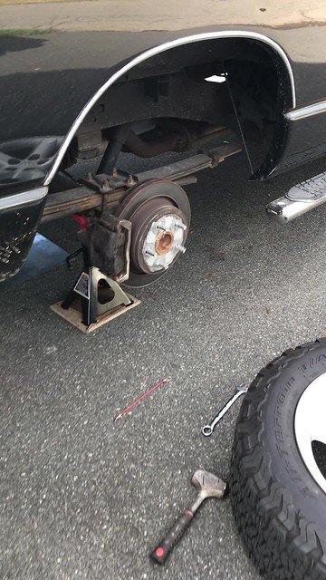

ok, unfortunately i finished the install, and nothing changed for the better. in fact the wobble was more distinct and noticable at a larger range of speeds. that sucks
i took some photos and videos that I plan on uploading to see if it may help me/us all figure out a determination/fix for this.
I even swapped teh left and right wheels, and no change.
I am thinking that as my next experiment, I mgith try a very very thin washer/spacer on one or two of the axle studs behind the brake rotor. in the videos I used a wax chalk to show the actual rotating gap of the components.
unless something is tweaked inside the differential(highly unlikely right?), I will lean on the opinion that something with the brake caliper, brake caliper mounting bracket, e brack setup, rotor face might be tweaked.
at some speeds i feel the rear end slightly gallup down the road. at very low speeds I can feel it "kick" as the tweaked component brings the rotor in contact with the brake pad, it kicks enough that I feel it in the steering wheel

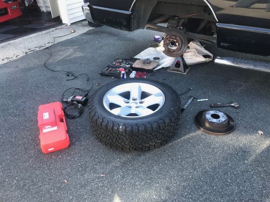

26361071789_834d758fa6_z.jpgTruck rear axle bearing replacement by David Martin, on Flickr
37427959524_c54807c8fb_z.jpgTruck rear axle bearing replacement by David Martin, on Flickr
37427960254_aaccd38d93_z.jpgTruck rear axle bearing replacement by David Martin, on Flickr

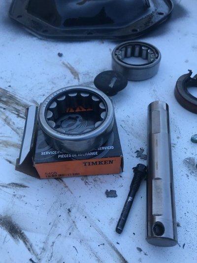

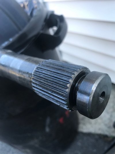

the wear pattern looks normal on the axle shaft. the bearing came out with only two pulls of the side hammer and seemed to spin effortlessly.

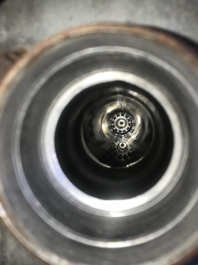

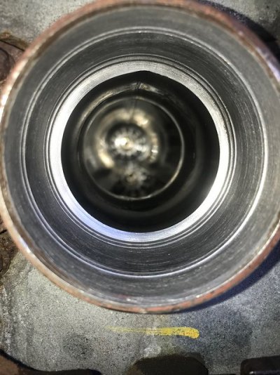

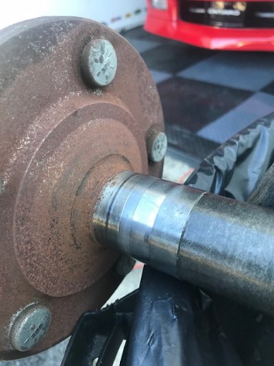

photo of the axle tube . at first I saw the top of the tube was out of round and was like holy #&@# ! then after a second, I realized that this is just how the tube is manufactured and this is where the tube is seam-welded shut. right? hope so!. I know the axle shaft does not ride that close to it, or the bearing would be destroyed.

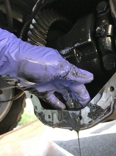

one thing that did get me a little worried is the amount of glittery metallic fluid that came out of the bottom of the axle housing. I had just changed this fluid out about 25k miles ago. thoughts???!

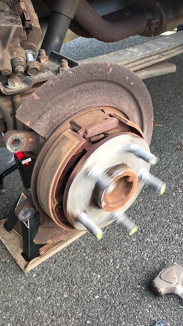

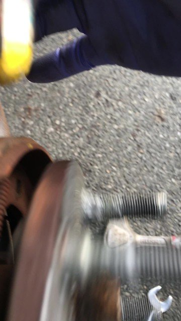

this is at the begining of the project... pre bearing removal:
38105764832_dae7406b8f_z.jpgTruck wheel bearing project by David Martin, on Flickr
In this video, you can clearly hear something grinding and scuffing. I thought for sure when I took everything apart, I would find a trashed bearing that was the cause of all this. to my dismay, the bearing is was just fine. leading to more confusion

THIS IS WITH TEH NEW BEARING AND SEAL INSTALLED. :
38105776942_8beea9efa6_z.jpgTruck wheel bearing project by David Martin, on Flickr
so, my thought here is that perhaps I can find some very thin washer/sspacers and find the "low" area of the rotor and shim it out tobe even with the leading surface of the rotor...as an experiment. mayeb the brake system is tweaked somehow and causing the rotor to spin akwardly, (remember i swapped rotors and wheels side to side also)

Hard to see in the video but it looks like a fair bit of runout (wobble) in the flange. I think about .001 possibly .002 inches is acceptable. I think the flange is bent. Think about the wobble there and add 15-18 inches to it in tire height. A bit of an issue I would think. It shouldn't be expensive to have it checked if you don't have the tools.
HF should also have what you need for under $50 also.
