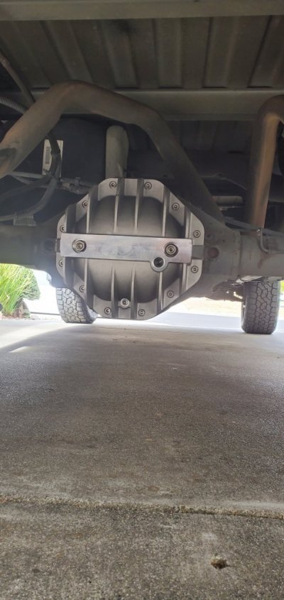

Just did the rear diff on my 2005 Ram 4x4 with 60k miles, I used Royal Purple and even though it says it has friction modifier in it, I also added a bottle from MOPAR. I also added the B&M diff cover for easier gear oil changes. I need to do the front diff next, I wish there was an aftermarket cover for my 2005.
