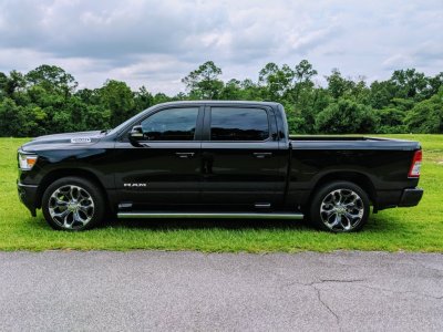

I have a 5th gen now, but I used their springs and am very happy!IMG_20190709_121153.jpg
