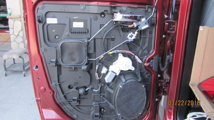

i think that you may need to get into the squarish rubber flap
see the stool with wheels?
the wheel closest to the edge of the door, is where the door actuator is, directly below that looks like a hole with 3 markings
I can't tell what the markings are, maybe a LOCK ?
It is midnight, so i am staying indoors.
That may mean that the rear seat has to be removed ??
