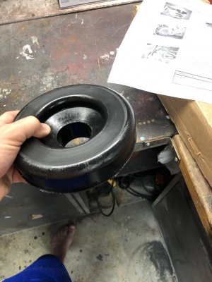

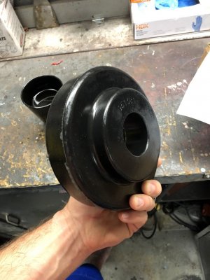

These are the spacers I put in, and also a comparison to the stock upper isolator it replaces. Nothing is fool proof of course, but I feel comfortable with this design. I feel like even in the unlikely event it did crack in half it would stay in place due to the way it seats into the spring and upper perch. Hope I never find out though!
They are all mostly built like that. Now I will say 98% of spaces are fine and will never break. Nobody leaves a good review, everybody leaves a bad review.
